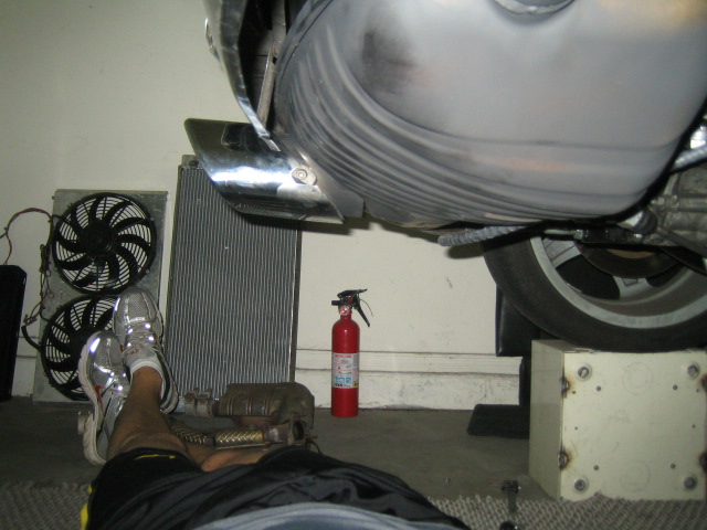

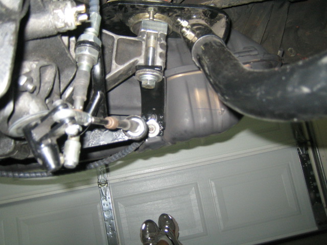

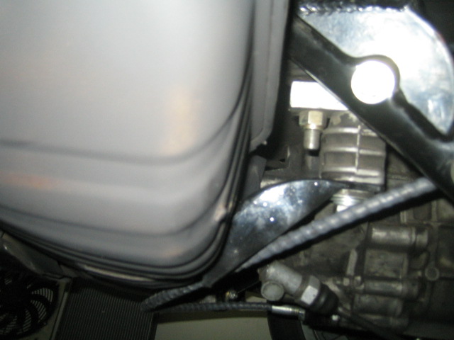

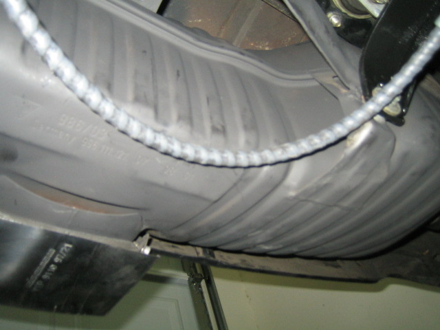

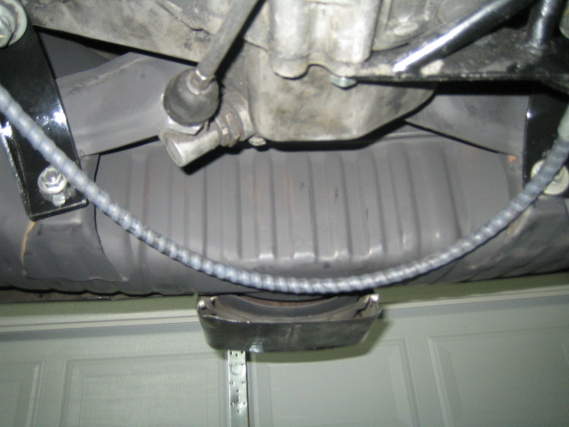

budman5201   Okay almost done guys. Here is my 2003 Boxster Muf...   May 11 2010, 10:18 PM
budman5201   Engine bay is done and engine in....a few pics bef...   May 11 2010, 10:30 PM
budman5201   more   May 11 2010, 10:31 PM
budman5201   more   May 11 2010, 10:32 PM
SirAndy   more You should use the stock cup washers on you...   May 27 2010, 04:12 PM
budman5201   more You should use the stock cup washers on yo...   May 29 2010, 12:07 AM
budman5201   more   May 11 2010, 10:33 PM
budman5201   more   May 11 2010, 10:34 PM
boxstr   Curious, why the battery so far down low and, to m...   May 11 2010, 11:14 PM
budman5201   Curious, why the battery so far down low and, to ...   May 11 2010, 11:47 PM
karmanbuilt   I'am curious too about the engine lid you...   May 12 2010, 12:32 AM
Zaney   I'am curious too about the engine lid you...   May 12 2010, 09:47 AM
charliew   I like the muffler and the battery location. You a...   May 12 2010, 10:37 AM
budman5201   I like the muffler and the battery location. You ...   May 12 2010, 02:09 PM
