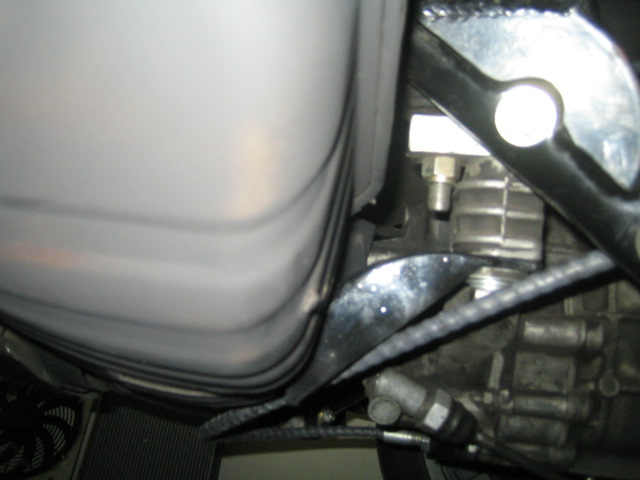

QUOTE(budman5201 @ May 11 2010, 09:32 PM) *
more
You should use the stock cup washers on your transmission mounts to prevent the tranny from sliding off the bolts ...
(IMG:style_emoticons/default/shades.gif) Andy
budman5201
post May 29 2010, 12:07 AM
Posts: 595
Joined: 1-April 07
From: tempe, az
Member No.: 7,635
QUOTE(SirAndy @ May 27 2010, 03:12 PM) *
more
Transmission sliding back off bolts......Impossible. The bolt that holds the aluminum bracket to the stock transmission mounts is right behind the ears of the transmission. They are so close to behind the ears you have to tighten them first then bolt the trans up.
