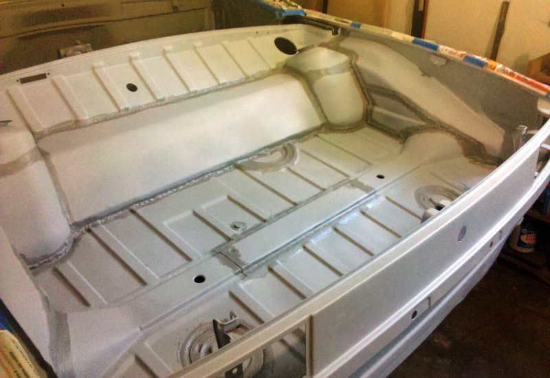

Painted the rear trunk and seam sealed the welds.

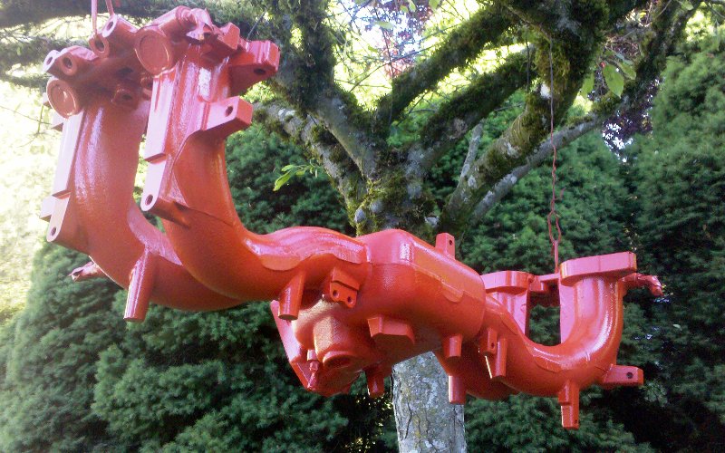

Painted the intake manifold with 500 degree chevy red-orange paint.

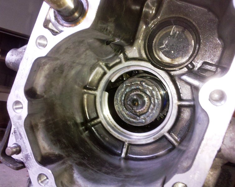

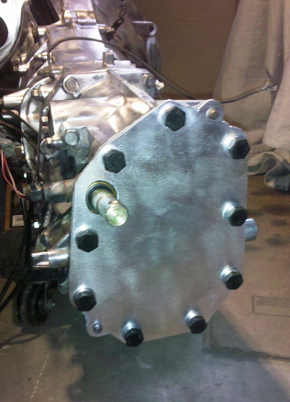

Used the DIY Bremar Coupling Thread and made my own plate to save myself $350.
