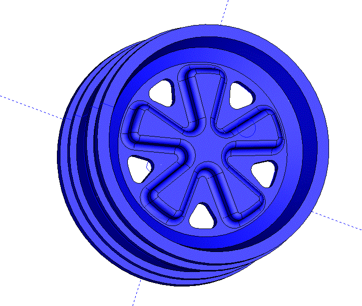

Screen shot from the drawing for prototype #4.
I've been comparing this to the wheel on my car... it's getting closer to the real thing. See the rounded edges and the sloped lip? (IMG:style_emoticons/default/biggrin.gif)
