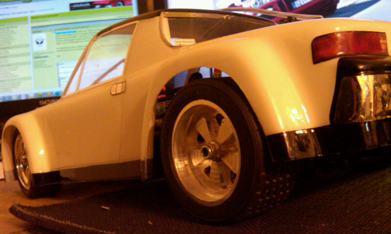

PS: Final version picture:
(IMG:http://www.914world.com/bbs2/uploads_offsite/www.smalltowngeek.net-8112-1333930199.1.jpg)
I now have two cars here, and I've got the measurements! I am ready to start cutting out the wheels. It will be easiest to do them if I do a larger run.
The process for cutting out the wheels requires me to set up my CNC mill in multiple configurations.
26 or 31mm widths. The tires these are designed for are the HPI vintage tires. If you'd like to run a different set, PM me or post here.
Here are a couple of teaser pics. The chunk missing was a glitch in the code, but has been resolved in the PC simulations.

prototype3 on the car...
Now I can get some measurements and SEE how they fit! I am so stoked!
Rick, THANK YOU!!!
Here's the pic. (IMG:style_emoticons/default/smile.gif)
