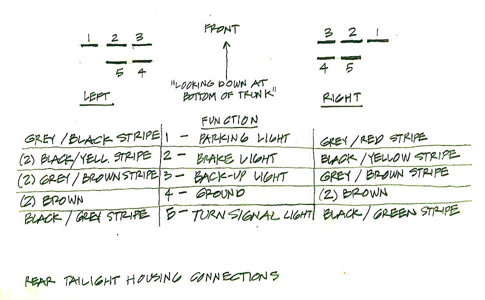

So my primary question is exactly what color are the brake light wires that I'll need to splice into; where are they located; and does anyone have a photo or two?!

I used a double connector spade on my driver side #2 break light and #4 ground. Extreamly simple.
Thanks for the diagram you're a life saver! Back out into the 95' degree weather to work on this air cooled machine! (IMG:style_emoticons/default/welder.gif)
