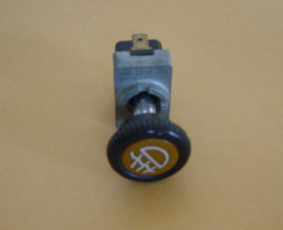

jfort   Does anyone know where I can buy a fog lamp switch...   Feb 12 2004, 09:25 AM
Bleyseng   I have a extra green fog lite switch laying around...   Feb 12 2004, 10:17 AM
415PB   Thanks Geoff, I'll tell the autozone guys to l...   Feb 12 2004, 03:50 PM
jfort   let me try this again. i need the green fog light...   Feb 14 2004, 07:28 AM
Gint   Hey Jeff, Geoff said he had a green fog light swi...   Feb 14 2004, 10:20 AM

Gint   One of you guys (Geoff or Craig) sell me a switch ...   Feb 14 2004, 10:46 AM

TimT   I think the early 911 fog light switch is the same...   Mar 15 2004, 05:00 PM
