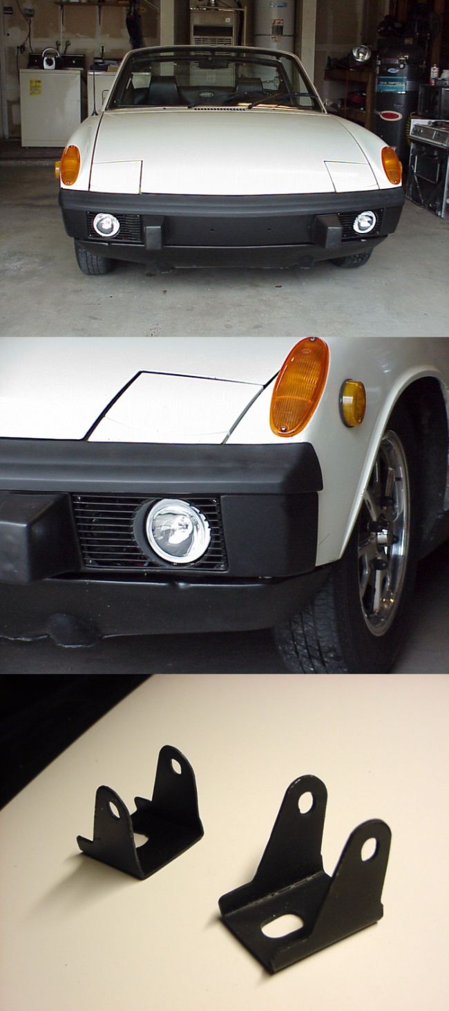

just to have a record on this board, i am in the process of installing driving lights where the fog lights go. i got some well-prepared grills from korjo. the lights mentioned in the attachment, made by Pilot, are indeed available from Auto Zone. About $45. I had the brackets made at a local shop. I'll let you know how it turns out.

I read through Demicks upgrade and installed the Pilot lights. I used his template for the bracket and made my own brackets. It came out pretty good. The brackets brought the light forward some to almost sit flush with the rear of the foglight grill.

jfort   got the Pilot driving lights installed, finally. ...   Mar 15 2004, 02:18 PM

415PB   I read through Demicks upgrade and installed the P...   Mar 15 2004, 11:59 PM
Bleyseng   Looks great! I have a set of pilots but haven...   Mar 16 2004, 09:09 AM
