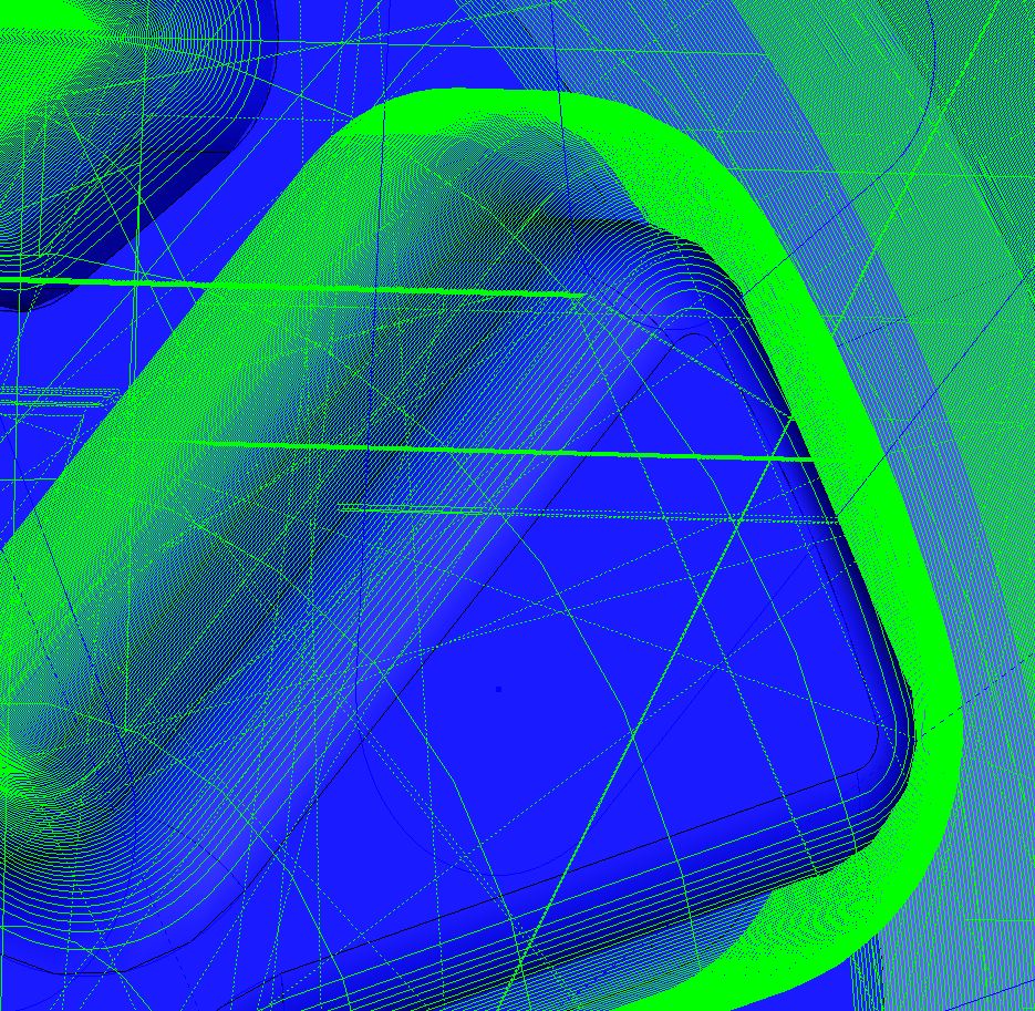

RJMII   I've been working on the 3d tool paths to get ...   Aug 3 2010, 10:45 AM
RJMII   zoomed in   Aug 3 2010, 10:46 AM

underthetire   Man, I just read some of your times for cutting. W...   Aug 9 2010, 01:56 PM
RJMII   Man, I just read some of your times for cutting. ...   Sep 21 2010, 07:46 PM
