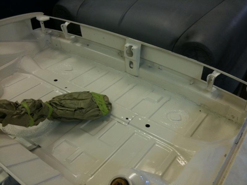

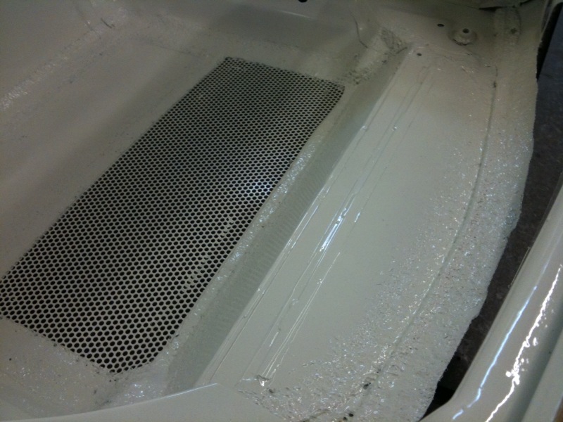

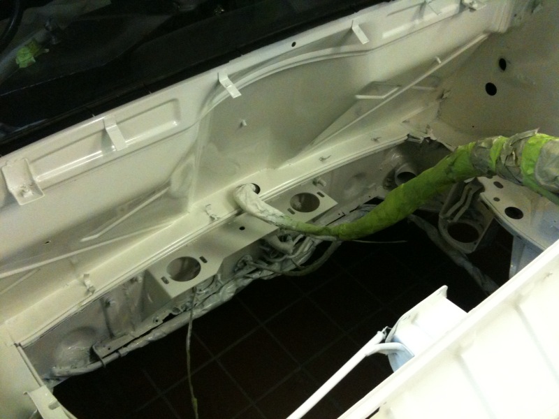

Bodywork is nearing completion. Some Pics:
I have decided to put in rear swaybar brackets so I can have the option to try out a rear swaybar. I got the brackets from Engman, but I think I will need to get a rear swaybar to place the brackets properly. I have a want add posted for an adjustable rear swarbay.
