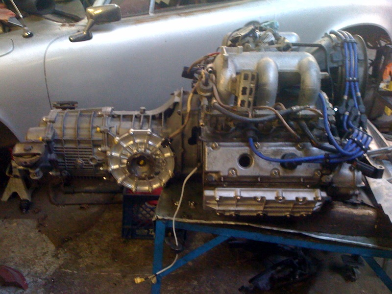

The engine is coming out next week. 3.0 in place of the 1.8.
Here's the car. My grandmother got her new in '74.
Here's the engine. '78 SC 3.0l.
Here's the trans. WEVO915 with GT 60/40 LSD. Keeps the 3.6 option open. (IMG:style_emoticons/default/idea.gif)

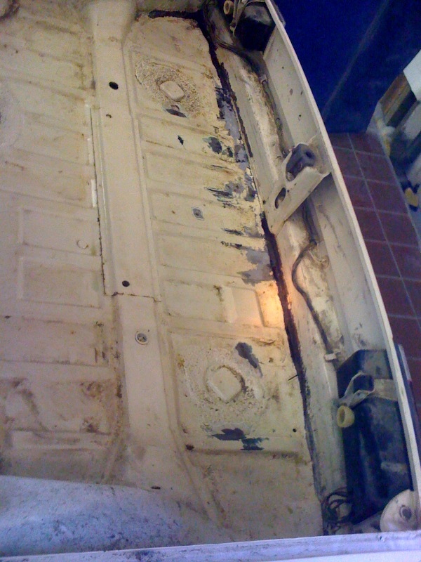

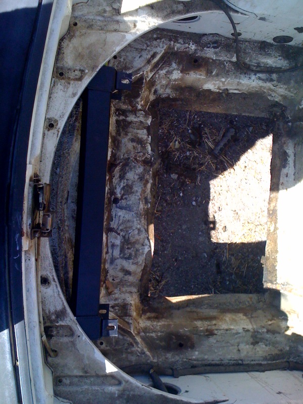

Hello again everyone. It's been a little while since updates.
Trial fitted the engine and trans. Fit nicely. Pulled it right back out. Here's how it sits.
GT oil cooler, Vertical spare and Battery are being placed in front. There is a huge hole in the front trunk from factory A/C that needs to be closed up a bit. Found some rust in the rear trunk. Removed the battery tray and found more rust. Luckily hell hole rust is only superficial. More superficial rust on the other side too.
