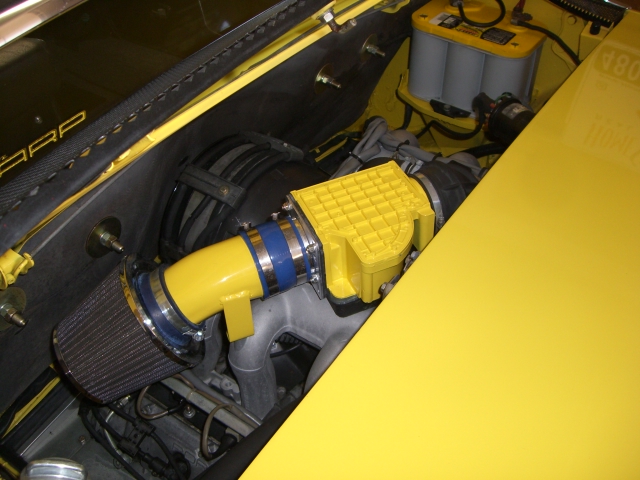

post Aug 20 2010, 08:42 AM
What size wheels can I fit?
Posts: 4,673
Joined: 5-April 05
From: Scottsdale, AZ
Member No.: 3,881
Here's how mine looks. No cutting or eliminating anything on the car and it fits. Not stock but fits perfectly.

MoveQik   Here's how mine looks. No cutting or eliminat...   Aug 20 2010, 08:42 AM
