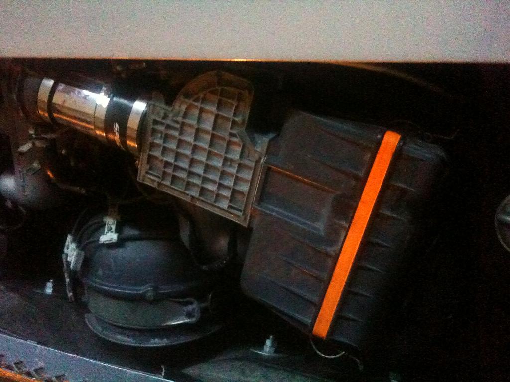

Anyone try flipping the intake 180° on the 3.2 to retain the stock airbox?

When I had the 3.2 out of the track car for the rebuild, I attempted rotating the intake 180 for grins. It does not fit without modifying the cooling shroud. I suppose it can be done, but not easily.
The track car was cut to allow the use of the stock air box. My street car was not cut and uses a K&N style air cleaner.
I was kicking around the idea to create a modded stock airbox so I can go back to a stock filter, but have not done so yet.
Trust me, you will like the 3.2 once you get it installed. I have 2 of them and love them both.

Thanks for sharing your experience with the intake. (IMG:style_emoticons/default/biggrin.gif)
I've been curious whether it would flip neatly or not. It looks so close, but not close enough to have convinced me to attempt a flip yet.

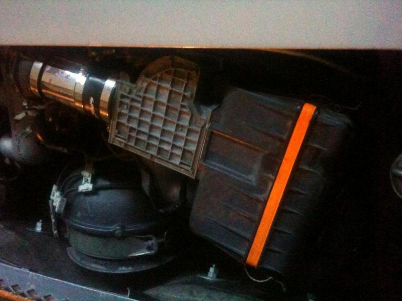

I'm using the stock air box on mine. Mine is a 1984 3.2 in a 75 914. All I had to do was extend the MAF and redo the mounts. No modification to the car. Sorry about the fuzzy IPhone picture. Parts consist of an extender and adapter from Pep Boys and L brackets from Home Depot to move the mounts closer to the firewall. What's also nice about the 3.2 is that you can use early 911 heater ducts off of the shroud to connect to stock or after market 914-6 heat exchangers. My car is running stock 914-6 heat exchangers and the car runs great!!
