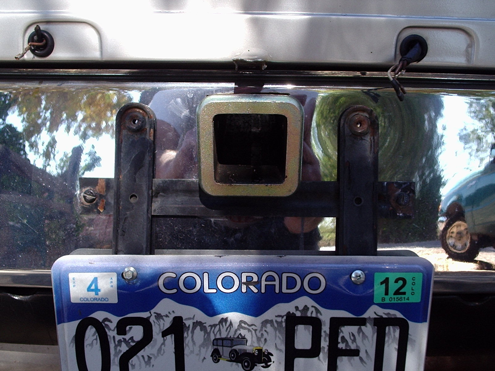

Majkos's hitch mount setup
Majkos comments on his setup. See previous posts as well for more info!
(IMG:http://www.914world.com/bbs2/uploads/post-1729-1287597471_thumb.jpg)

majkos   Here's mine :D   Oct 20 2010, 11:58 AM
Andyrew   Here's mine :D Kevin, Awesome hitch moun...   Oct 20 2010, 12:28 PM

majkos   With lead designer from Alien, Rick we came up wi...   Oct 20 2010, 02:34 PM
majkos   Sacrifice a very nice bumper. :evilgrin:   Oct 20 2010, 02:39 PM
Tom_T   Sacrifice a very nice bumper. :evilgrin: Intere...   Oct 20 2010, 03:28 PM
majkos   Answers 1) Very easy to set up, no scratches 2)Sam...   Oct 20 2010, 02:51 PM
Andyrew   I dont see a locking pin on that receiver, was tha...   Oct 20 2010, 03:00 PM
majkos   I dont see a locking pin on that receiver, was th...   Oct 20 2010, 03:20 PM
