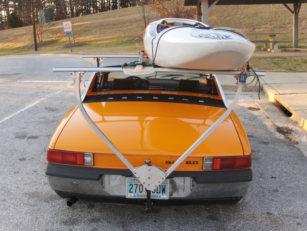

Here are some photos of my set up. I have a 1 1/4 inch receiver mounted just below the bumper. This enables me to leave the tag in place. It accepts a standard bike carrier. I have a set of bars that attach to the rear receiver, and also to the rear of the roll bar. This allows me to carry 2 kayaks. It doesn't add any load to the front windshield frame, and also allows me to remove the top if I want. I can also access both the rear trunk and engine compartment with everything installed and loaded. The receiver has a steel tube that is supported on the rear of the car by two 3/16 inch bars. The inner portion of the tube is welded to a 1/2 inch bar that is bent to go up and over the muffler and transmission. I have a few bolts through the trunk floor that hold the 1/2 inch bar. I have trailered a 30 foot long sailplane trailer with this set up, no problems. JoeO

Joe Owensby   Here are some photos of my set up. I have a 1 1/4...   Oct 23 2010, 10:27 PM

Joe Owensby   Side view of both bars, and detail of rear end of ...   Oct 23 2010, 10:33 PM
Andyrew   Joe, I saw your rack and I like it! But I di...   Oct 23 2010, 10:40 PM
Joe Owensby   Receiver is a standard 1 1/4 inch tube that is mou...   Oct 24 2010, 09:33 AM
