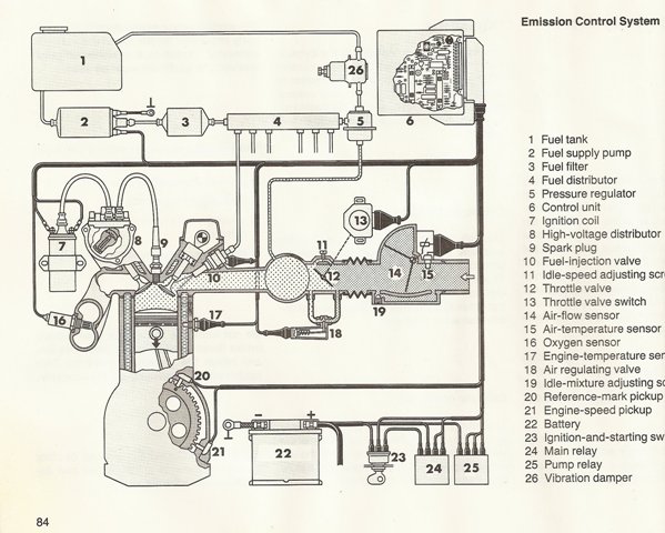

I found this diagram last night in the owners manual that came with the 911....good diagram highlighting all the connection points.

jim912928   I found this diagram last night in the owners manu...   Dec 7 2010, 02:46 PM
