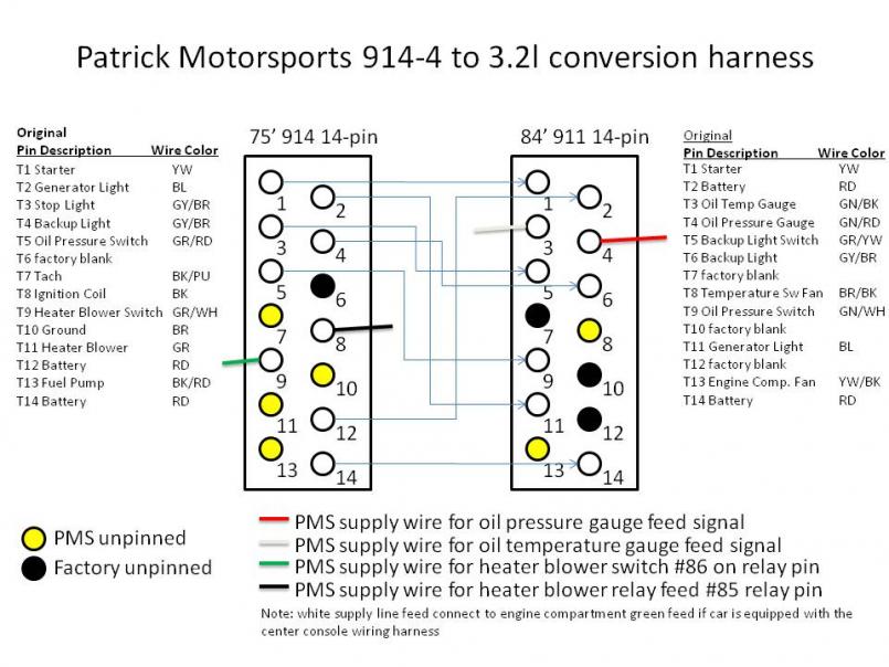

I bought and learned how to use a multimeter! So, after pouring through all the "current flow diagrams" and all the good electric information supplied so far...I thought I'd publish how the Patrick Motorsports 914-4 to 3.2l conversion harness is pinned out (eliminates the relay board). Note, he has also provisioned some extra wires on both ends of the harness to help with six gauges on one side and 914-4 heater blower on the 914 side. So, here is my crudely done diagram (sorry...used powerpoint to draw it)!
