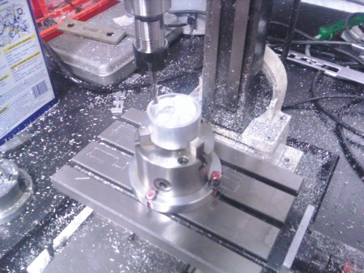

The 3 Jaw chuck bolts directly to my mill bed, or the rotary table. It holds the wheels in place MUCH more securely than the little vise I was using.

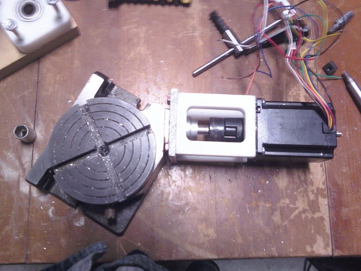

The rotary table also has a new addition; a stepper motor! Now it needs wired and the backlash taken out.
