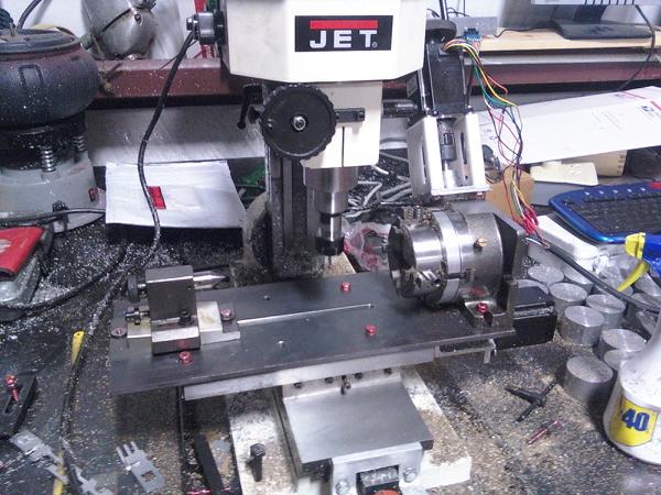

4th axis and tailstock bolted to the mill. I should be able to work on the code for the area the tire mounts in on the outside of the wheel now.

RJMII   4th axis and tailstock bolted to the mill. I shoul...   Dec 23 2010, 07:52 PM
