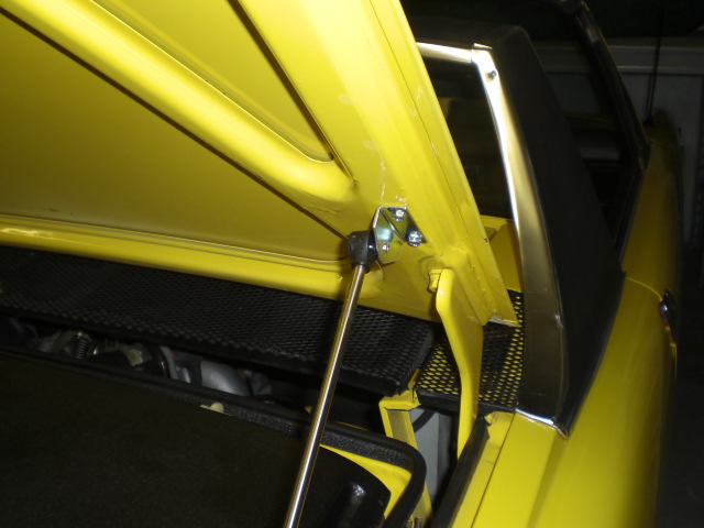

How is the install w/o cutting, I thought my instructions skat to cut a small notch...guess it's a good thing I haven't installed them. Change the mounting positions. Mount the shock further *back* on the deck lid instead of the hinge. That way it doesn't need to go into the engine bay. Then move the mounting point on the trunk accordingly. (IMG:style_emoticons/default/smile.gif) There is still enough leverage that the trunk lid shuts easily without too much flex. Attached image(s) ![]() |

How is the install w/o cutting, I thought my instructions skat to cut a small notch...guess it's a good thing I haven't installed them. Change the mounting positions. Mount the shock further *back* on the deck lid instead of the hinge. That way it doesn't need to go into the engine bay. Then move the mounting point on the trunk accordingly. (IMG:style_emoticons/default/smile.gif) There is still enough leverage that the trunk lid shuts easily without too much flex. Damn and damn! Wish I had seen this before I cut my trunk!! |
