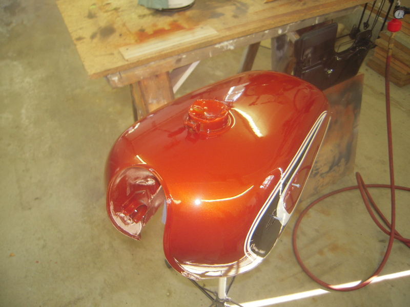

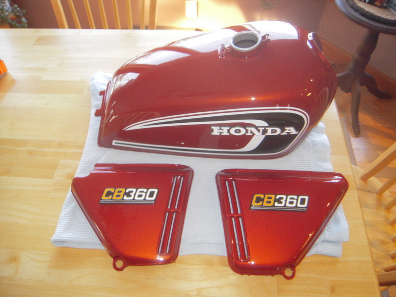

I would just get real automotive base and clearcoat. I'm restoring an old Honda and I bought a cheap gun from Harbor Freight. I spent about $60 on some inexpensive PPG Omni base and a PPG clearcoat. I used a two-part aerosol epoxy primer from SprayMax. This was with no sanding after the basecoat and I've done nothing to the clearcoat. And I've got enough materials left over to do about ten more tanks and side covers.
