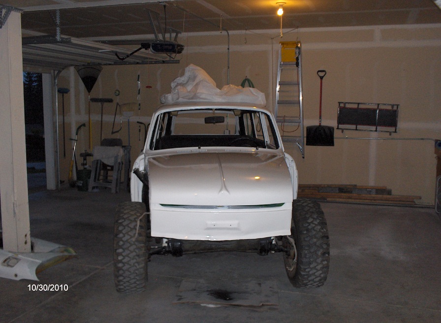

I did my entire squareback with 2 quarts of Apline White (L80E or L90E?), a gallon of reducer and pint of hardener. All that cost about $125. Then I purchased about 8-9 of the Preval air cans for $2.86 each at a local hardware store, so another $26 or so.
$150, painted with real auto paint, hardener, reducer etc.
I guess we are lucky around here we can still buy the paint. Good option if you have it.

Root_Werks   I did my entire squareback with 2 quarts of Apline...   Feb 1 2011, 10:02 AM
Root_Werks   The rear fenders:   Feb 1 2011, 10:04 AM
