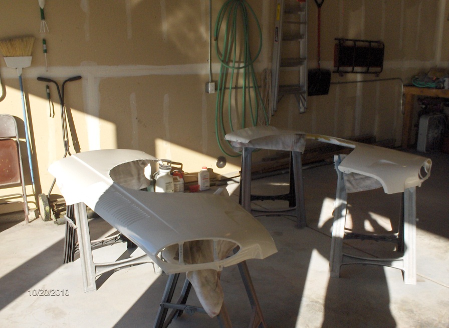

Root_Werks   I did my entire squareback with 2 quarts of Apline...   Feb 1 2011, 10:02 AM
Root_Werks   The rear fenders:   Feb 1 2011, 10:04 AM
