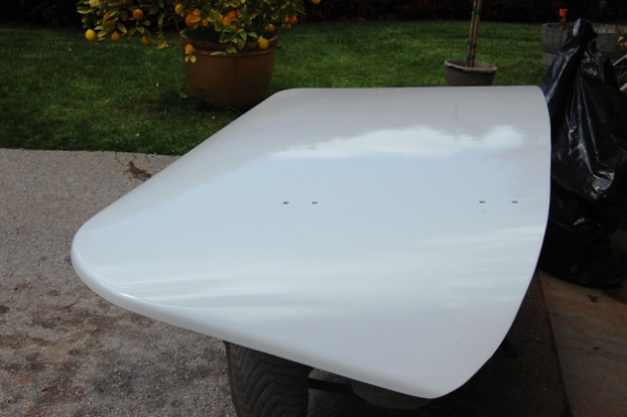

The gloss white is a dead match for Grand Prix White, i.e., a Porsche color, and I got the proof.
PS
When I was a kid, visiting my folks in Laguna in the summer, there were a couple of guys that lived up the street that restored Corvettes. For a paint job they just went down to Miracle and had them do a standard production job. When they got the car back they color sanded the entire car with 600 then 1000 then 1500 and the cars were beautiful.
I wonder if you couldn't save a lot of time by just putting on 3 or 4 coats and then sanding. I think I will try color sanding my spoiler on the trailer and figure it out.
