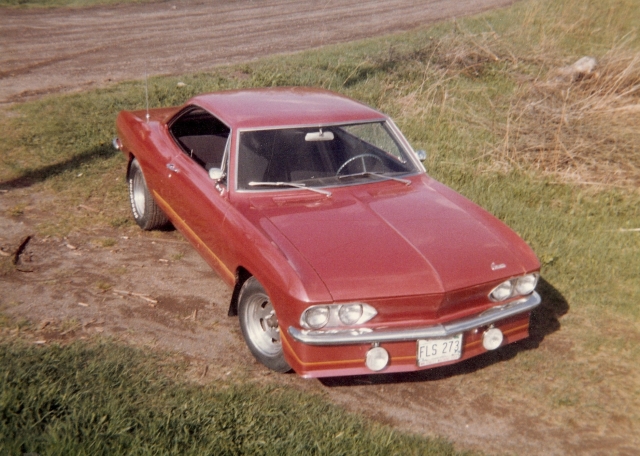

Ya, the engine spins in the wrong direction but there are cams and dizzy's that fix that. I happen to have had several corvairs. The engines run nice and sound sweet.
Here's one of my old vairs.
