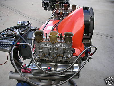

Feb 17 2011, 07:24 PM
I'm sure you'd get some serious double-takes with this baby in the engne bay!
One thing I can say about the 'Vair engine, is that fan makes some serious noise above 3-4Krpm! In the buggies I've ridden in (both mid-engine Deserters) the fan noise dominates all other noises at higher rpm's. Not sure about the upright fan conversion?
Unfortunately, the heads seem to the the biggest drawback. Some serious $$ needs to be spent to make the big HP numbers - especially when you go with IR intakes, slant port exhaust, P&P - Ka-ching! Plenty of hi-po parts available though.
