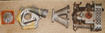

I started driving Corvair turbo's in the mid 70's. Put the 6 up for the winters and drove the Corvair
.060 forged pistons and a Chevy 409 Oil Pump. Total Seal Rings and a big E-Flow turbo, Weber 2 barrel 40DCOE Carb, Water Injection.. Fun highway car.
They are known for dropping valve seats and beating them into the Piston tops and spitting the pieces down the exhaust, into the turbo. makes quite a mess.
I have seen a fix where they "stake " the valve seats into the heads though.
Stock, I don't think they turn any serious revs, around 5500 RPM.. I'm sure that could be addressed.. An upright 911 type fan would be help keep the belt on.
The setup the DR. has with the big bore VW P/C's sounds like the way to go.
Also, the 3 barrel Weber setup used 140HP big Valve heads. You machine off the existing manifolds from the heads and buy adapters. Not cheap to buy, But the machining work is nothing beyond what I have seen some members here do on a daily basis.
Cheap to buy and build compared to Porsche Engines and many parts available, including roller rockers and big turbo's.
