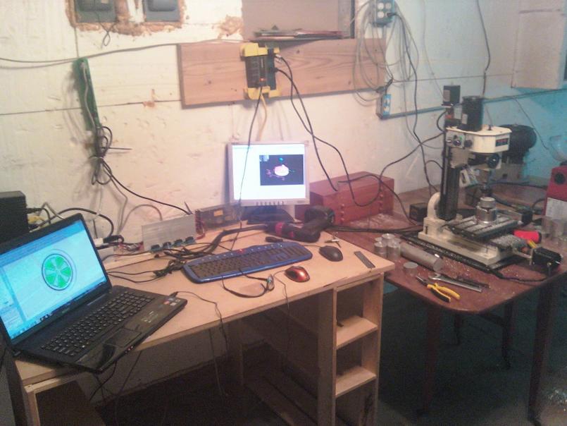

I now have two cars here, and I've got the measurements! I am ready to start cutting out the wheels. It will be easiest to do them if I do a larger run.
The process for cutting out the wheels requires me to set up my CNC mill in multiple configurations.
26 or 31mm widths. The tires these are designed for are the HPI vintage tires. If you'd like to run a different set, PM me or post here.
Here are a couple of teaser pics. The chunk missing was a glitch in the code, but has been resolved in the PC simulations.

We moved last month, and my brother was kind enough to spend the day on one of his weekends off to help me relocate all of my machining equpment from my dad's shop to the garage that is basically on the other side of the wall from my living room. My CNC mill is less that 30 foot from my couch that I lounge on while healing and resting. (IMG:style_emoticons/default/smile.gif) Things are getting easier and looking up for me.

RJMII   4th axis and tailstock bolted to the mill. I shoul...   Dec 23 2010, 07:52 PM
RJMII   We moved last month, and my brother was kind enoug...   Apr 21 2011, 04:54 PM
RJMII   a close up of the tool path on my EMC/linux box. ...   Apr 21 2011, 04:56 PM
RJMII   This is the beginning of the pile of blanks that a...   Apr 21 2011, 04:57 PM
RJMII   This is the wheel that was cut out from the above ...   Apr 21 2011, 04:58 PM
