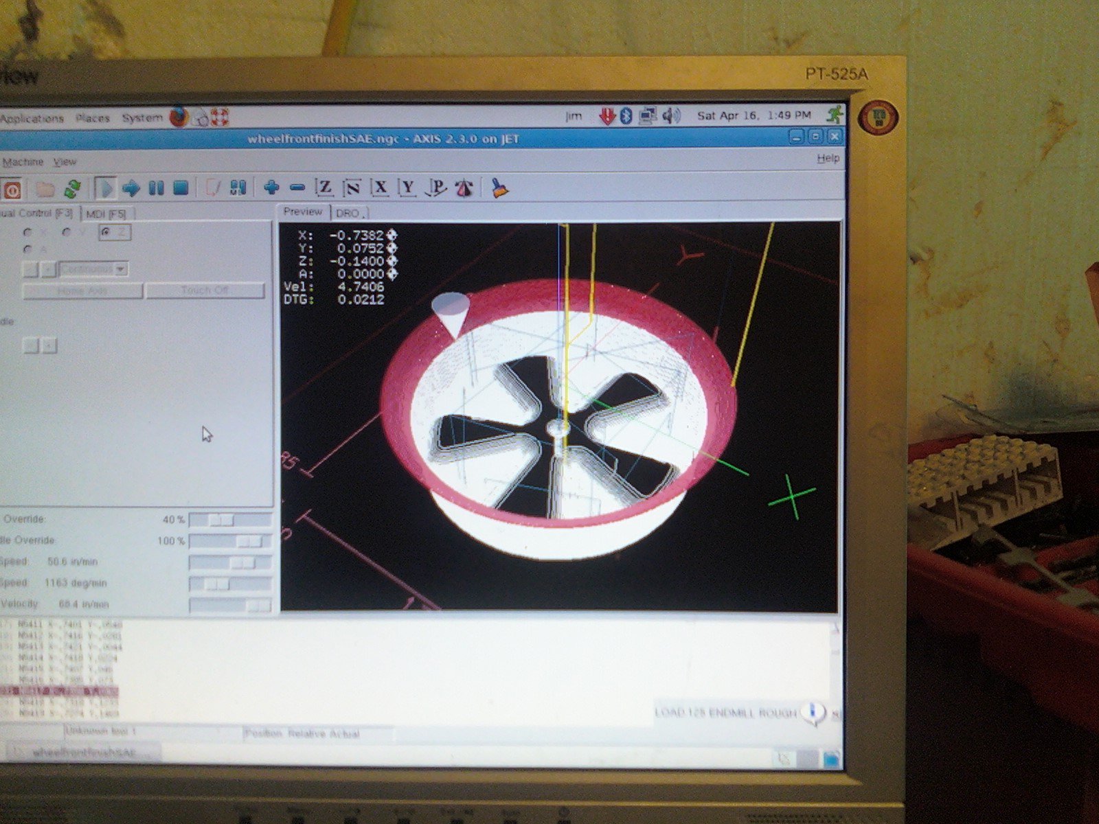

a close up of the tool path on my EMC/linux box.
the red lines are the ones that are done for this particular wheel.

RJMII   a close up of the tool path on my EMC/linux box. ...   Apr 21 2011, 04:56 PM
