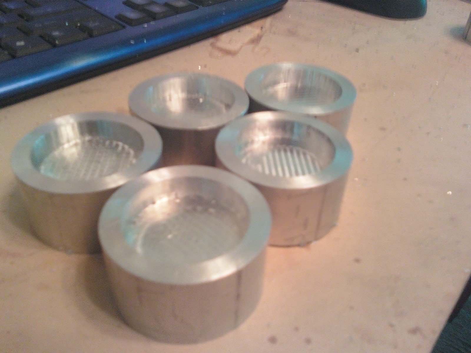

RJMII   beginnings of COOKIES!   Aug 9 2010, 12:57 PM

rick 918-S   The cookies look diffecult... :wacko:   Aug 10 2010, 07:41 AM
RJMII   I keep looking for used mini lathes that I can co...   Aug 10 2010, 08:18 AM
