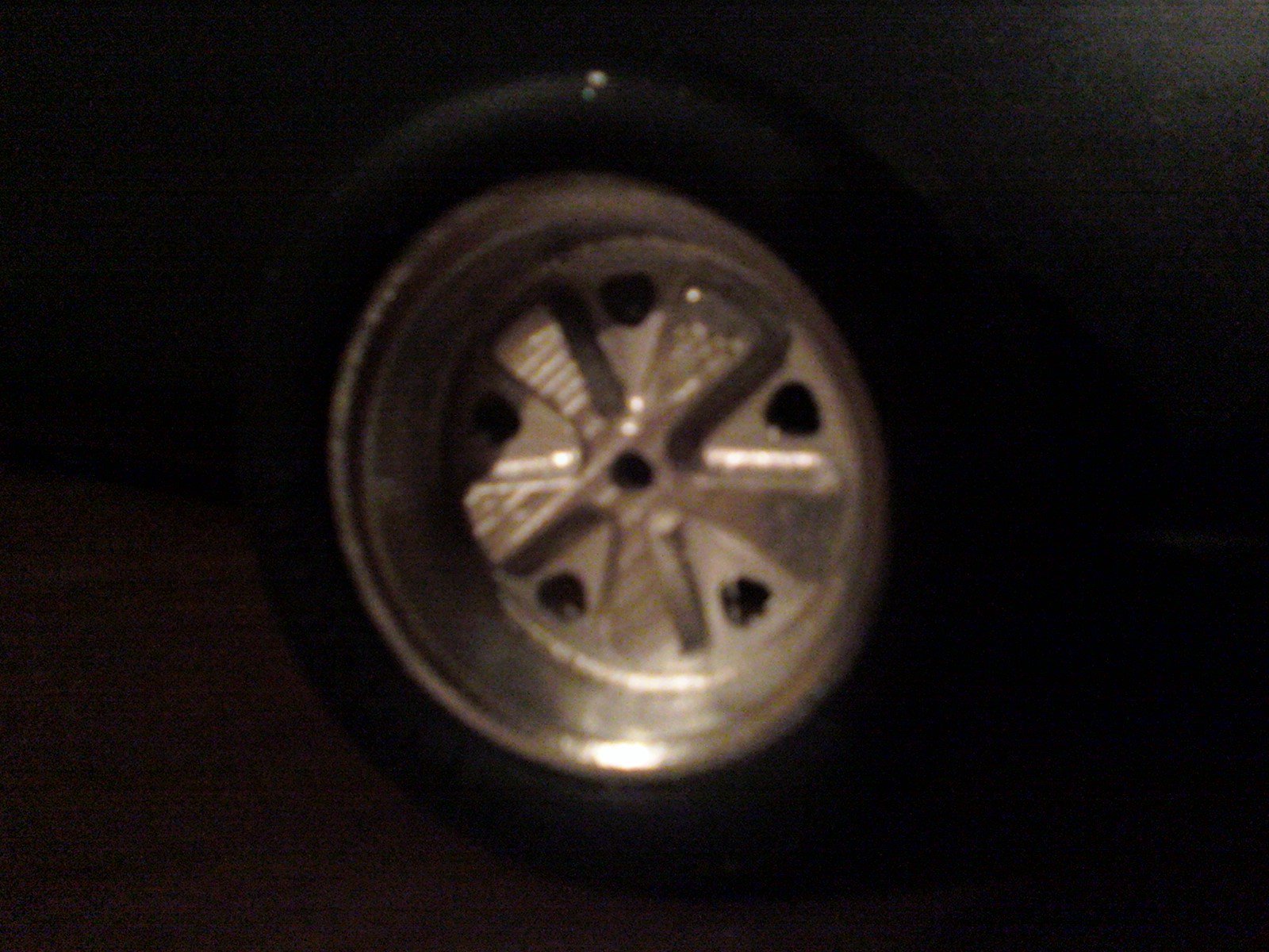

I now have two cars here, and I've got the measurements! I am ready to start cutting out the wheels. It will be easiest to do them if I do a larger run.
The process for cutting out the wheels requires me to set up my CNC mill in multiple configurations.
26 or 31mm widths. The tires these are designed for are the HPI vintage tires. If you'd like to run a different set, PM me or post here.
Here are a couple of teaser pics. The chunk missing was a glitch in the code, but has been resolved in the PC simulations.

and here is another one that had a couple of glitches on the back side, and the 3 jaw chuck was .030" off center for the face. It's now a paperweight somewhere else w/out the tire on it.
