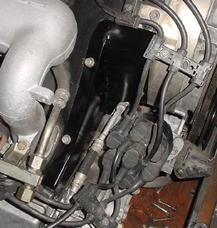

I suppose that I should confess that this was not my FIRST conversion, and I have been wrenching on 914's for more than 20 years, and that I am accustomed to fabricating what I need and patiently build my collection piece by piece.
Currently, I am collecting for my 930 engine to put into a DE 914. My shell was free, the engine was removed from my 930 (I swapped motors in that), I have a 915 to mate to it (with a Vellios kit).
I do need time to put it all together and I have yet to figure out how best to fabricate an exhaust for the beast.

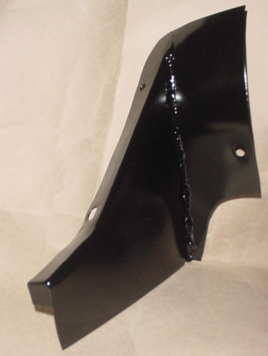

What machine did you use to fabricate your block off plates?
John
post Jun 30 2011, 10:15 PM
member? what's a member?
Posts: 3,393
Joined: 30-January 04
From: Evansville, IN (SIRPCA)
Member No.: 1,615
QUOTE(patssle @ Jun 30 2011, 08:09 PM) *
QUOTE(John @ Jun 30 2011, 05:57 PM) *
Machine?
I used a plasma cutter to cut out sheet metal from a pattern, a hammer to form into shape, a welder to weld it up, a hand punch to punch holes.......
