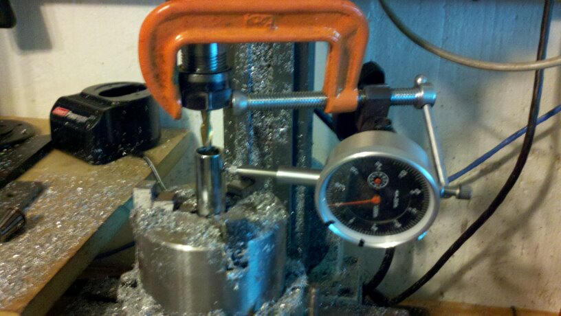

This should help find center. (IMG:style_emoticons/default/smile.gif)

RJMII   This should help find center. :)   Aug 27 2011, 02:33 PM
