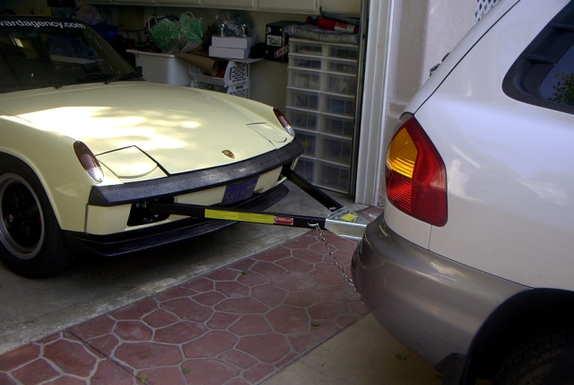

At the Marina Auto-x, Ken Holladay (sp?) towed his car to the event behind his RV (I would think anything with the towing capacity would work)
Ken or anyone else that does this, can you share some details or tips or pictures on how you setup the car and the supporting hardware???
I have a trailer, but sometimes it would be nice to tow the car without having to use the trailer.
Thanks
Howard

Pic 2

URY914   I use to flat tow my car all over the place. Used...   Apr 29 2004, 11:49 AM
Howard   Interesting, that's my today project. Bought ...   Apr 29 2004, 11:59 AM

URY914   The problem is the sheet metal behind the bumper i...   Apr 29 2004, 12:29 PM
!   I mounted it with a plate behind the t-bar mounts.   Apr 29 2004, 12:31 PM
Mueller   are there limitations with regards to turning or b...   Apr 29 2004, 12:50 PM
URY914   Yes, you can only back up if you're very strig...   Apr 29 2004, 01:05 PM

KenH   My "tow bar" attachment hardware goes thru the gri...   Apr 29 2004, 02:54 PM
jonwatts   Yes mikez sent me a VW towbar and Brad helped me m...   Apr 29 2004, 03:32 PM
Howard   As usual with my projects, I goofed and mounted pl...   Apr 29 2004, 06:27 PM

Howard   Thanks for the kind words. John, I did look at the...   Apr 30 2004, 12:57 AM

Demick   Hope you put some backing plates behind those brac...   Apr 30 2004, 08:31 AM
James Adams   I built one that bolts to the front suspension mou...   Apr 30 2004, 08:47 AM

porschenut   I am setting up a 76 for flat tow, I welded the bu...   Apr 30 2004, 10:58 AM
