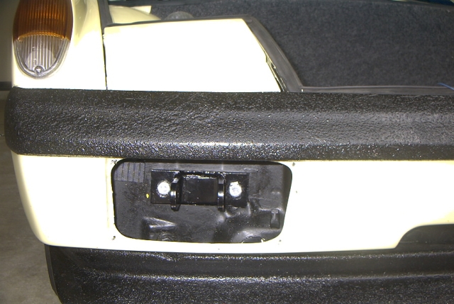

At the Marina Auto-x, Ken Holladay (sp?) towed his car to the event behind his RV (I would think anything with the towing capacity would work)
Ken or anyone else that does this, can you share some details or tips or pictures on how you setup the car and the supporting hardware???
I have a trailer, but sometimes it would be nice to tow the car without having to use the trailer.
Thanks
Howard

Thanks for the kind words.
John, I did look at the Cayenne, but the Hyundai came with a better CD ($50,000+ (IMG:style_emoticons/default/biggrin.gif) )
Paul, guess you figured that out, too. I have the 2.7, and while it does pull OK, bet the 3.5 with its low speed peak torque would do much better.
Installation was just drilling 4 1/2" holes. Piece of cake. Reaching behind to tighten the nuts was interesting, but doable. Here's the link to the kit. $45 plus shipping. Nicely made, and nice people.
