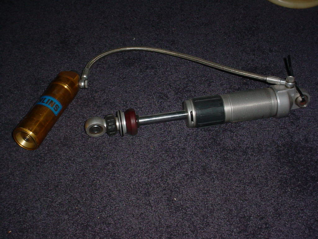

Thorshammer   Okay Okay! I'll chime in! The fox is ...   May 21 2004, 01:14 PM
itsa914
  May 21 2004, 01:35 PM
Thorshammer   Sorry Would 'nt accept my JPG file for some re...   May 21 2004, 02:12 PM
Thorshammer   Try this!   May 21 2004, 02:14 PM
