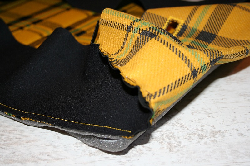

Assemble the plaid and the vinyl with needles in the tight curve.
(IMG:http://www.914world.com/bbs2/uploads_offsite/johannes.roussel.free.fr-5409-1339237183.1.jpg)

johannes   Assemble the plaid and the vinyl with needles in t...   Jun 9 2012, 04:20 AM
johannes   Sew the tight curve. You can sew a few time. It ca...   Jun 9 2012, 04:20 AM
