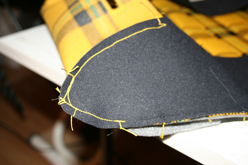

Sew the tight curve. You can sew a few time. It can look messy, the important thing is to have a smooth inner line.
(IMG:http://www.914world.com/bbs2/uploads_offsite/johannes.roussel.free.fr-5409-1339237220.1.jpg)
