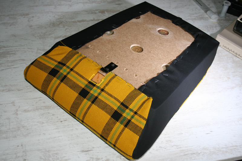

Stapple the cover on the cardboard. I had to redo the cardboard because it was warped and in bad shape.

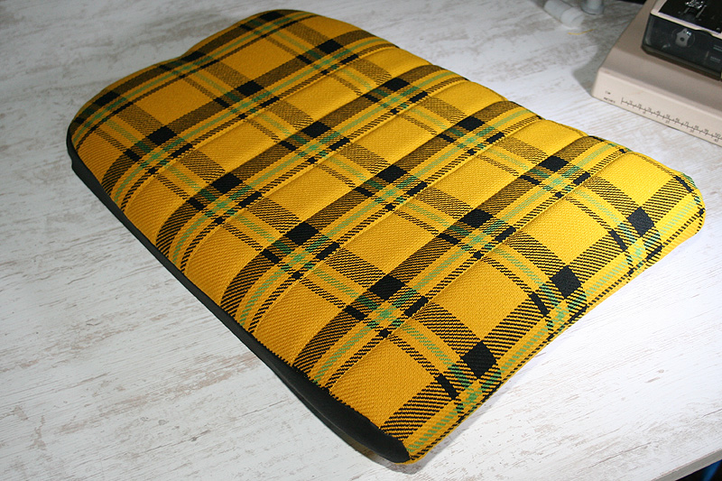

Nice ?...
(IMG:http://www.914world.com/bbs2/uploads_offsite/johannes.roussel.free.fr-5409-1339255121.2.jpg)
