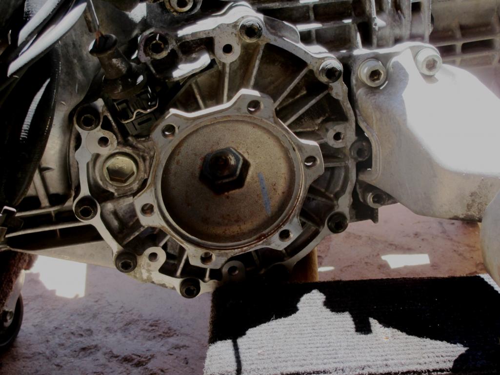

Here is the challenge. The transaxle. Either I fab an adapter, Fab an axle to take 1 Porsche CV and 1 Audi/VW CV or Replace with Boxster tranny, that will: Bolt right on, Shifter is cheap and available and requires less fab time. I'm leaning to the Boxster due to the 100mm Porsche CV flange. The Audi is 114mm.

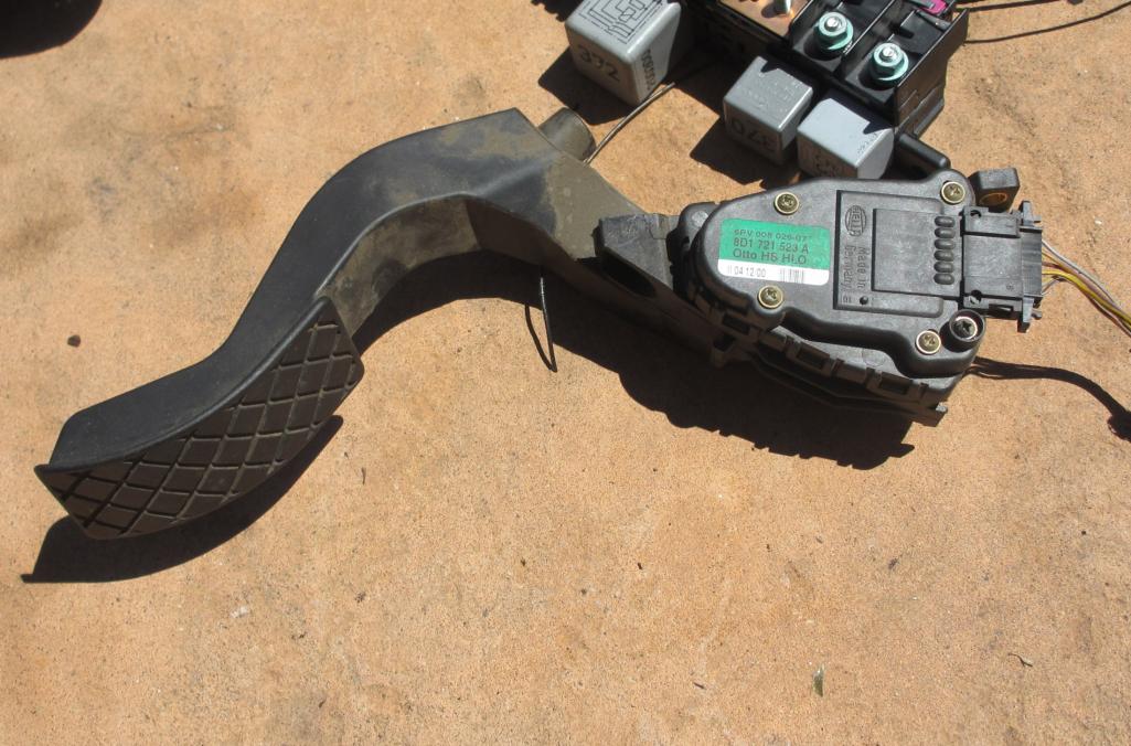

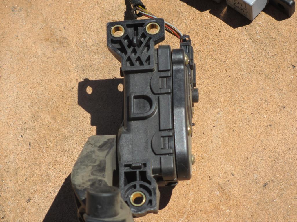

Here is the Electronic Gas Pedal... Pretty cool. Should be pretty easy to build a bracket for it...
Close up of the tranny flange. The Audi CV looks like it has a thicker shaft too.
