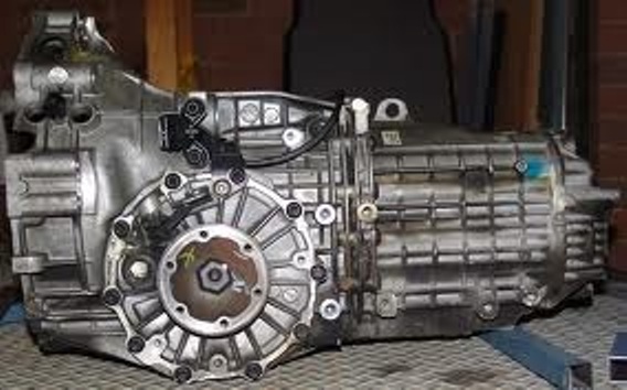

Here is the challenge. The transaxle. Either I fab an adapter, Fab an axle to take 1 Porsche CV and 1 Audi/VW CV or Replace with Boxster tranny, that will: Bolt right on, Shifter is cheap and available and requires less fab time. I'm leaning to the Boxster due to the 100mm Porsche CV flange. The Audi is 114mm.

Here's a photo of an 012 trans with the flanges that are compatible with the Porsche CV's.
Andys

I'm going down the road of trying to live with the 901 I've got, but a Boxster/Audi 5 speed swap is of great interest - otherwise I wouldn't give you any grief over this. (Probably.) (IMG:style_emoticons/default/sunglasses.gif)
Part numbers for those compatible output flanges or adapters? I'll also accept a smack upside the head with a pointer to a build thread...

andys   I believe you can swap out the tripoid transaxle f...   Jun 10 2012, 06:11 PM

Chris Scott   Mike, Check to see about poping out the drive flan...   Jun 10 2012, 11:04 PM

kg6dxn   If the flanges are held in with a circlip, they lo...   Jun 11 2012, 09:29 PM

Chris Scott   Mike, If i remember correctly the drive flanges ju...   Jun 11 2012, 11:15 PM
kg6dxn   Mike, If i remember correctly the drive flanges j...   Jun 11 2012, 11:22 PM
Chris Scott   That is what I remember   Jun 12 2012, 12:03 AM

kg6dxn   Got the flanges out. Just the the VW manual said t...   Jun 16 2012, 07:20 PM
