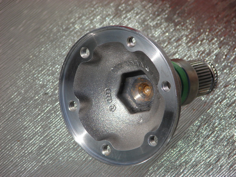

Here is the challenge. The transaxle. Either I fab an adapter, Fab an axle to take 1 Porsche CV and 1 Audi/VW CV or Replace with Boxster tranny, that will: Bolt right on, Shifter is cheap and available and requires less fab time. I'm leaning to the Boxster due to the 100mm Porsche CV flange. The Audi is 114mm.

Mike,
If i remember correctly the drive flanges just pop out. I just went out and looked at my car and can not remember removing any hidden clips or anything. Pretty sure about that.

QUOTE(Chris Scott @ Jun 11 2012, 10:15 PM) *
Mike,
Chris
Is this what they look like?

kg6dxn   If the flanges are held in with a circlip, they lo...   Jun 11 2012, 09:29 PM

Chris Scott   Mike, If i remember correctly the drive flanges ju...   Jun 11 2012, 11:15 PM
kg6dxn   Mike, If i remember correctly the drive flanges j...   Jun 11 2012, 11:22 PM
Chris Scott   That is what I remember   Jun 12 2012, 12:03 AM

jcd914   Anybody ever pulled the axle flange on a Boxster ...   Jun 16 2012, 01:36 AM

kg6dxn   Got the flanges out. Just the the VW manual said t...   Jun 16 2012, 07:20 PM
