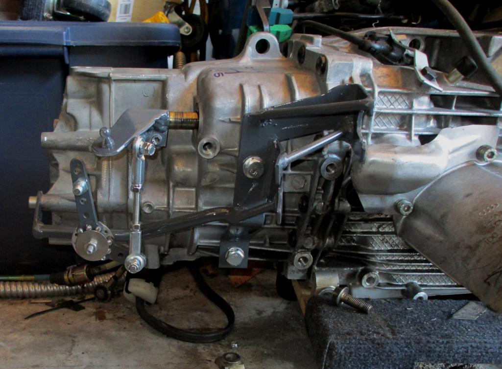

Got it finished and painted. Moved the cable inboard, the angle looks better. I plan to keep the (Audi Only) axle shield. But the cast aluminum Audi tranny mounts have been replaced with Boxster Steel units. This will give the mounts some symmetry over the Audi's.

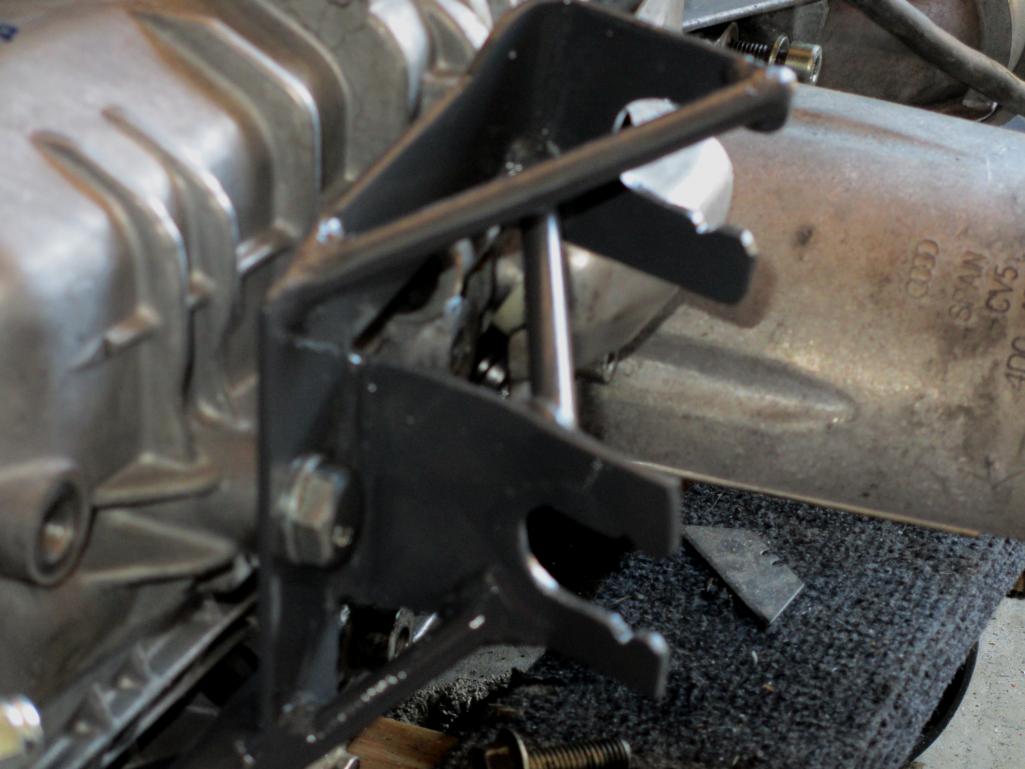

Here you can see the notch needded to capture the factory locking clip.

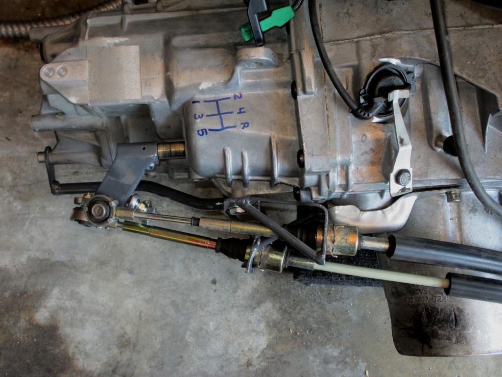

kg6dxn   Been taking it slow on the conversion. Here's ...   Aug 11 2012, 09:17 PM
kg6dxn   quick video... Linkage in action... fc8ZPVFrucw   Aug 11 2012, 10:30 PM
Andyrew   Mike, That shifter setup looks awesome! Im...   Aug 12 2012, 03:28 PM
