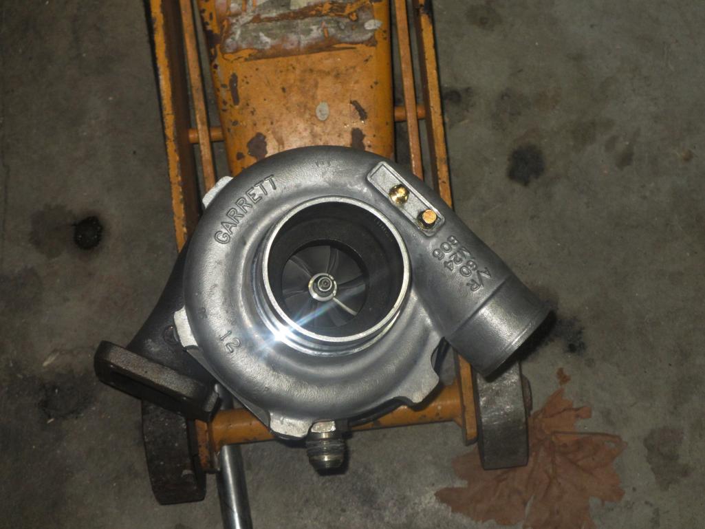

Teaser photos... Rotary gets pulled this weekend. New turbo good for up to 350hp. Not sure which exhaust manifold to use. I need to get the engine in place to see where the turbo fits best...
Garrett GT28RS Disco Potato...

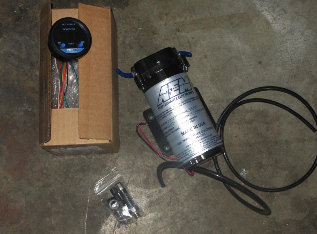

Methanol Injection... Coolingmist progressive controller gauge with vac/boost display, fail safe control, flow meter, AEM 200 psi pump, 600cc injector, hose, misc fittings. Not shown is the 2 gallon tank...

Andyrew   350 with that turbo will take ~ 22psi. I had 330hp...   Sep 22 2012, 09:49 PM
kg6dxn   350 with that turbo will take ~ 22psi. I had 330h...   Sep 23 2012, 05:26 PM
