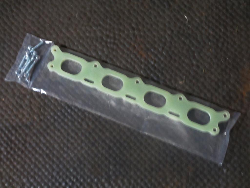

Fenolic intake spacer. 034 says it can lower the manifold temp by 20F. can't hurt...

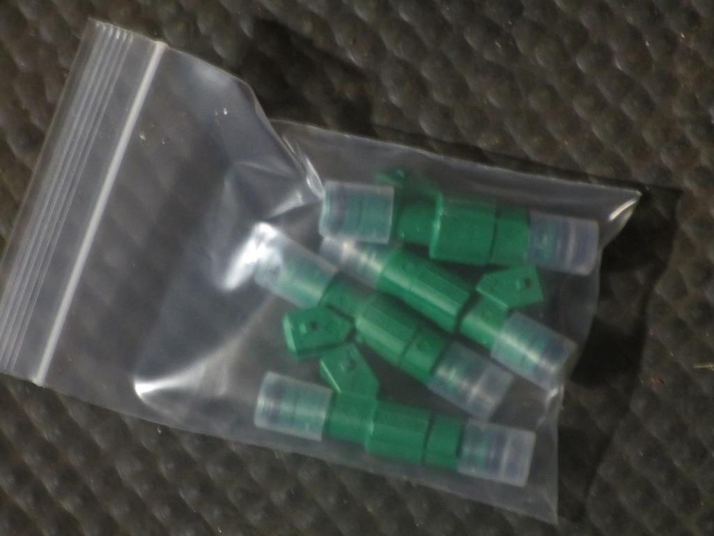

430cc injectors...

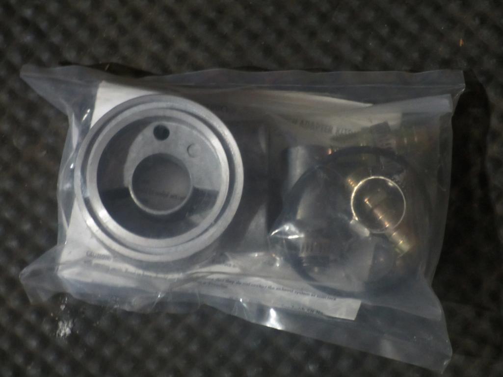

Oil sandwich to connect my external oil cooler. Now I need to flush out all the dino oil from the system...

kg6dxn   Fenolic intake spacer. 034 says it can lower the m...   Sep 20 2012, 10:53 PM
396   Very very slick and trick..Good luck with your con...   Sep 20 2012, 11:07 PM
kg6dxn   Very very slick and trick..Good luck with your co...   Sep 20 2012, 11:29 PM
Andyrew   I've heard mixed reviews on the intake spacer....   Sep 21 2012, 08:55 AM
