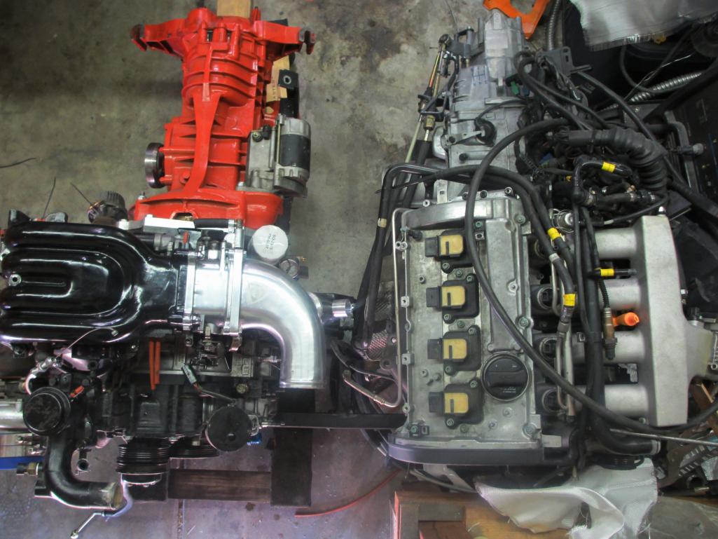

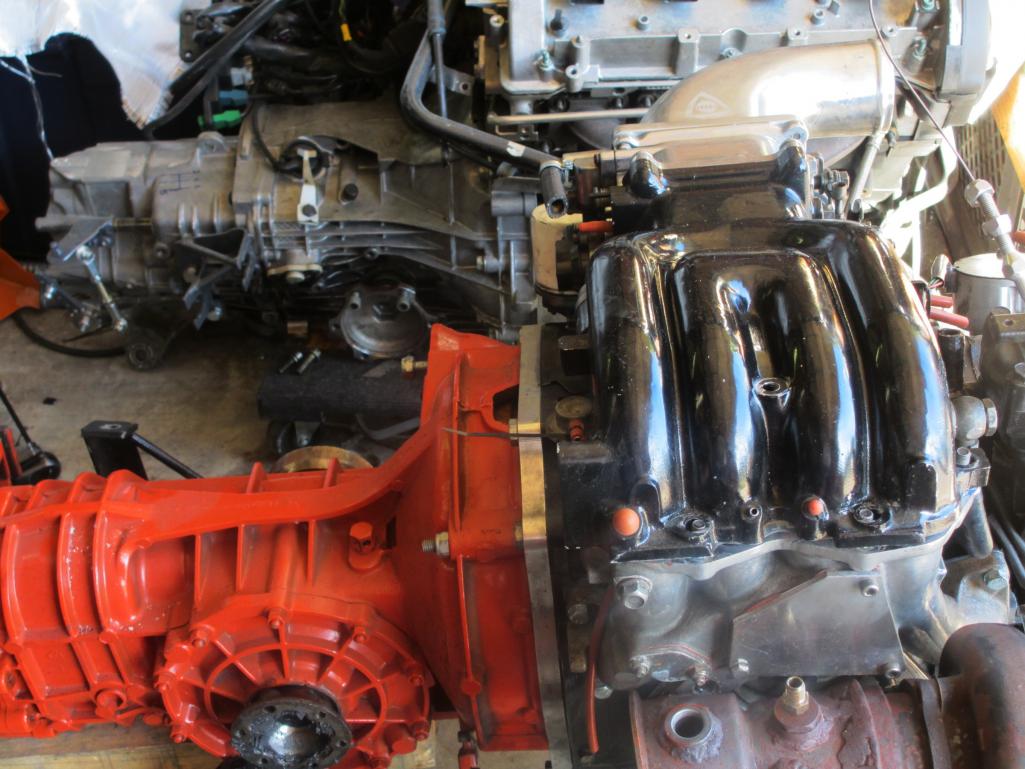

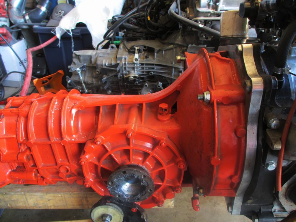

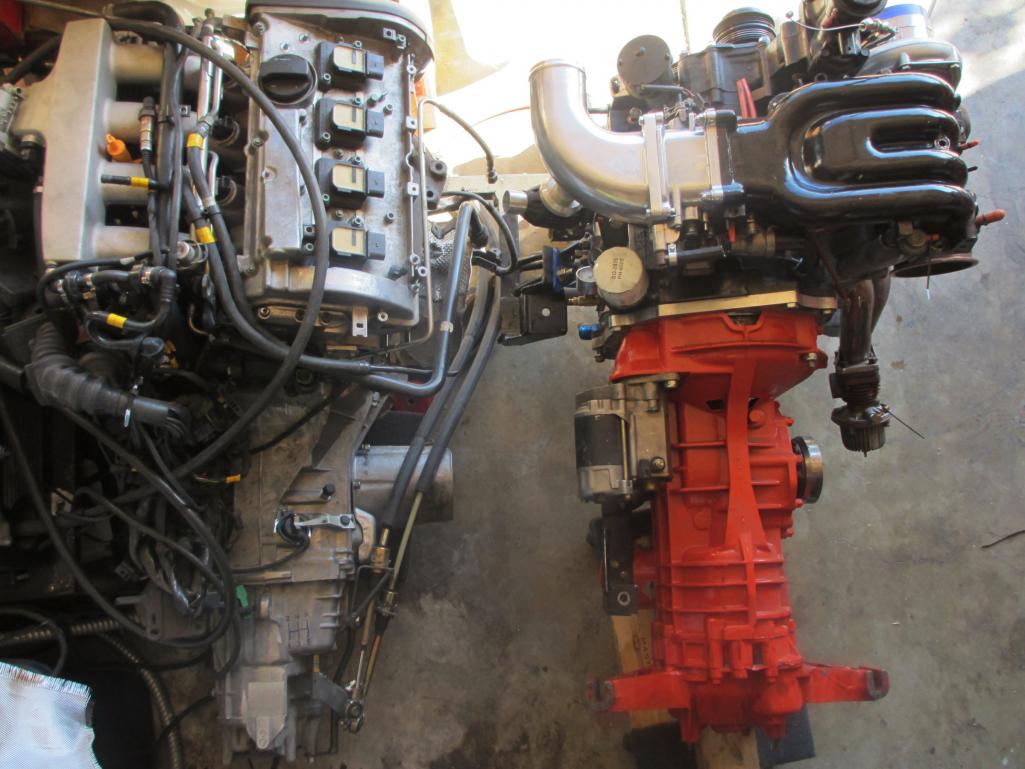

Pulled the drive train today. Kind of depressing since it still runs... (IMG:style_emoticons/default/sad.gif) Some of these parts have new owners (IMG:style_emoticons/default/piratenanner.gif)
The Audi/Boxster tranny is almost the same length as the 901. Only about an inch or so longer. From the bell housing to axle center looks exactly the same. At least you can't "eye ball" any difference. I may have to move it forward for engine clearance. No more than an inch. Looks like fitting it in will be no problem compared to what I have done already. The biggest bonus will be the modern transaxle. get in line now if you want to test drive it later. This thing shifts... well, it shifts just like a Boxster. (IMG:style_emoticons/default/smile.gif) Night and day compared to a 901.
My ECU goes to 034 Motorsport next week. $850 to turn it into a 350hp ECU with no smog or un-needed junk. OUCH! (IMG:style_emoticons/default/blink.gif) But I get to keep the drive by wire. I may have to have them put it on the dyno to fine tune the flash once it's driveable.
Here's some side by side pics for those that want to see...
