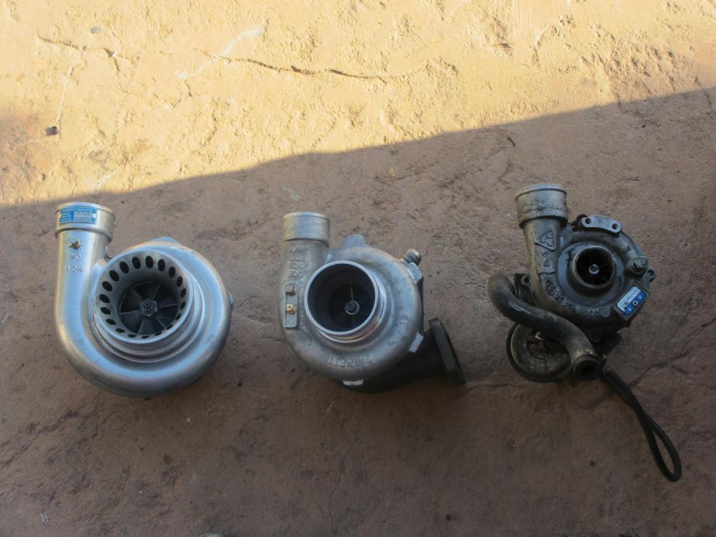

Just for fun... Picture of my 3 turbos... Big differences
from left to right:
1) GT35R from the rotary (~600hp max)
2) GT28RS for the Audi (~350hp max)
3) McMarks future K03 from the Audi (~225hp max)
