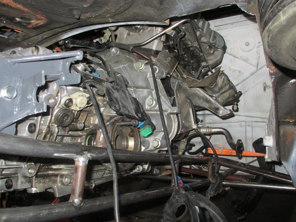

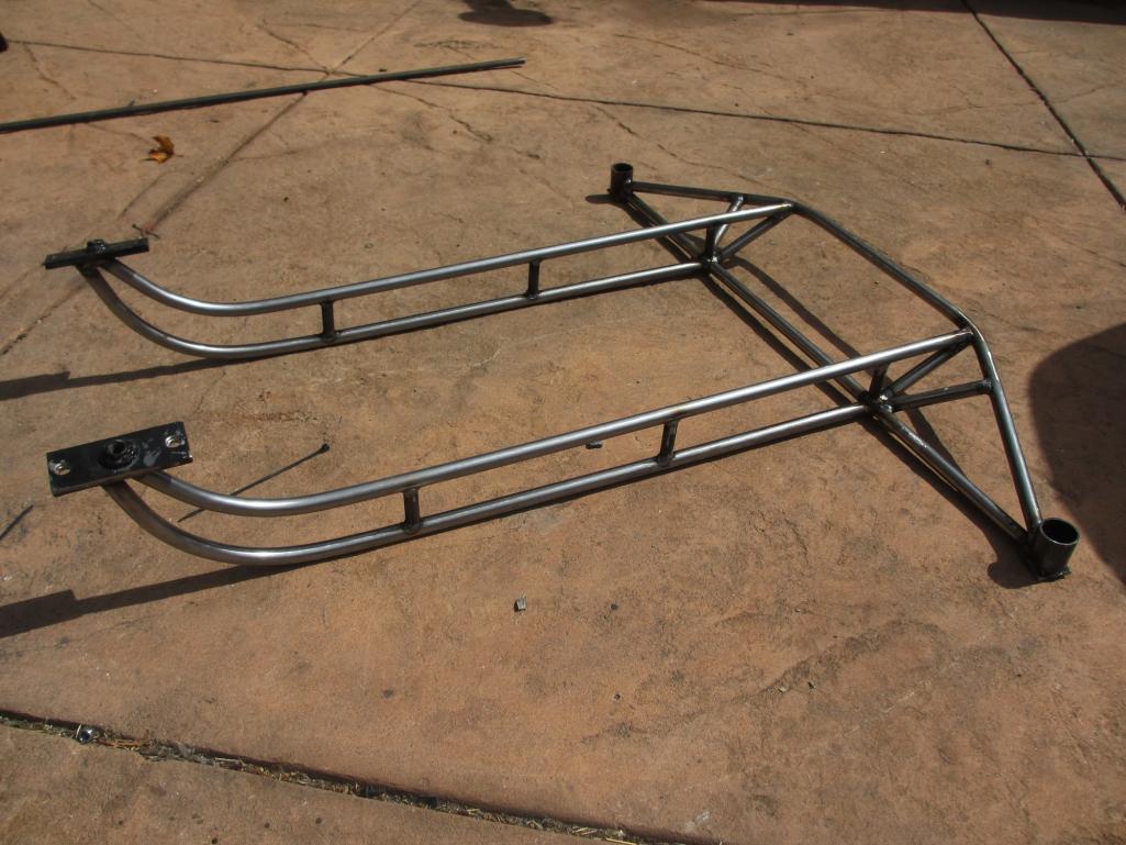

Got the cradle fabbed up. still needs some bracing and finishing. Need to cut the straight bar in front of the axle stub and weld in a drop loop for clearance. Most is 0.75" DOM, 0.120 wall and some 5/8" DOM, 0.120 wall tubing For the lattice sections. It weighs a little over 20lbs so far. Super rigid, no flex. I squeezed the engine into the bay. I have a copper shim (3/8')between the oil pan and the cradle bar. This will be the clearance for the engine. Some ratchet straps in place to hep level and center until the mounts are added to the cradle. The front has a triangulated arch and the rear is dual arches. I decided to go solid mount, no bushings. I know it will be a little louder and transmit the vibrations more, but this is the way both my V8's were and my old drag race Bug so I'm used to it.

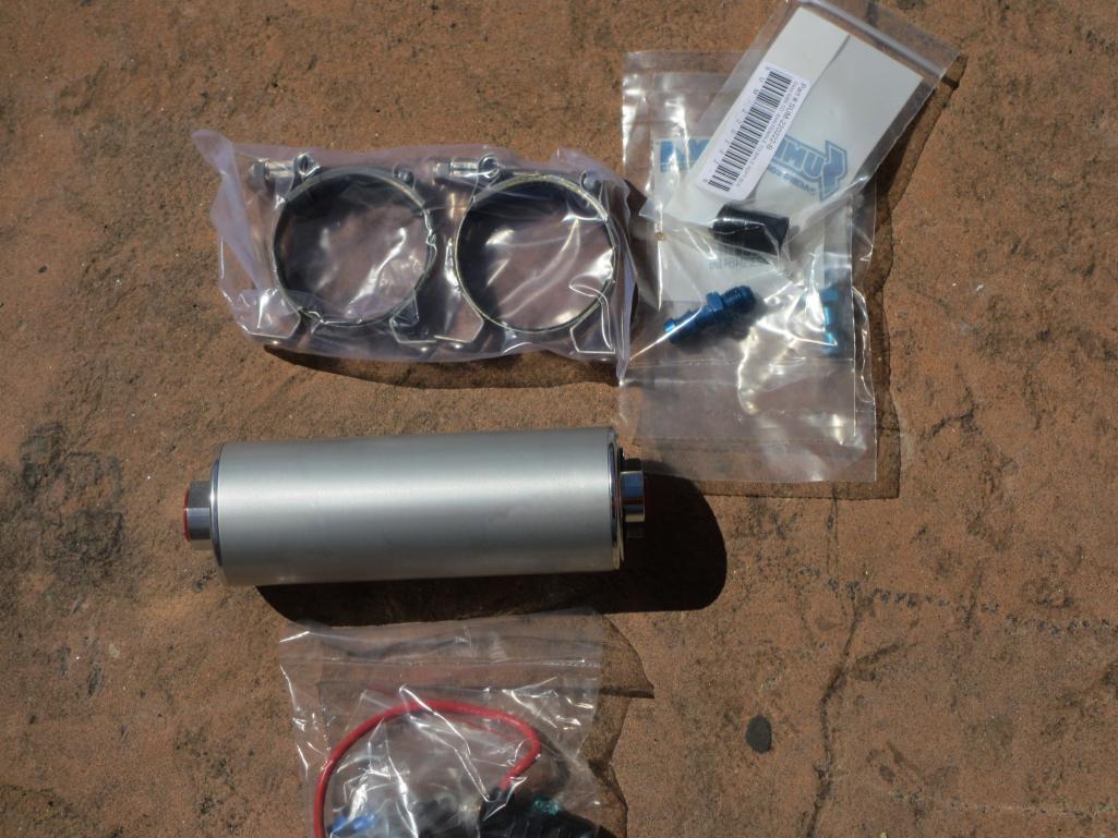

My new fuel pump showed up today. The Audi need 4 bar of pressure (65psi). This is the standard pressure for the motor. If anyone needs a good 45psi pump PM me, I'll let it go pretty cheap.

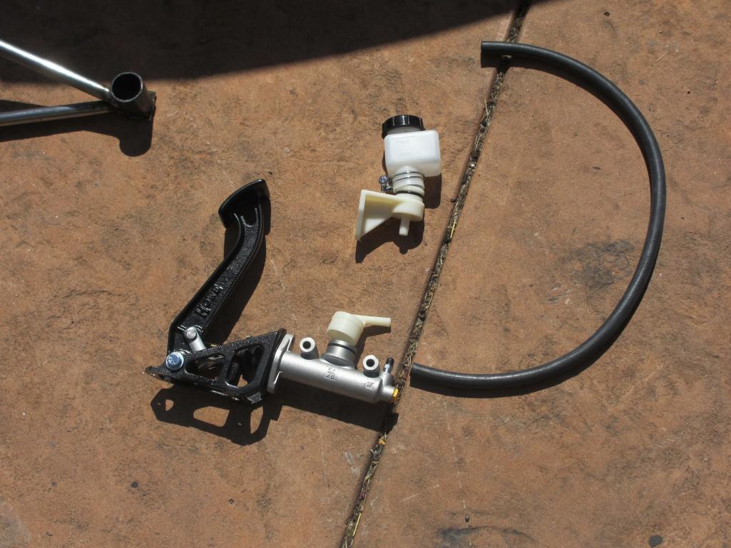

I also got a Howe Pedal and Wilwood master for the clutch. 034 Motorsport sells an adapter for the stock slave to accept a -3AN fitting. No need for a custom slave and the adapter was cheap. Now I have to decide if I want to replace the brake pedal and master. The brakes work great as is so I may just leave it for now and ad it to the honey do list after I get it on the road.

kg6dxn   Got the cradle fabbed up. still needs some bracing...   Oct 6 2012, 09:44 PM
kg6dxn   One more just for fun... Engine in the bay. I wil...   Oct 6 2012, 09:48 PM
