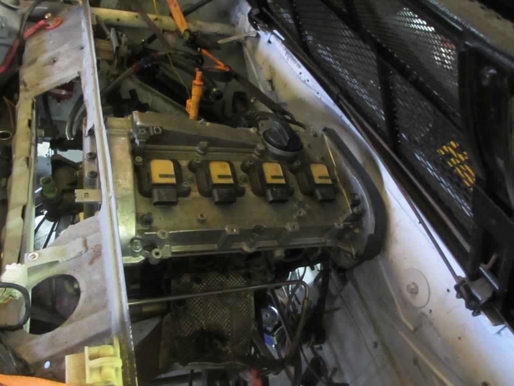

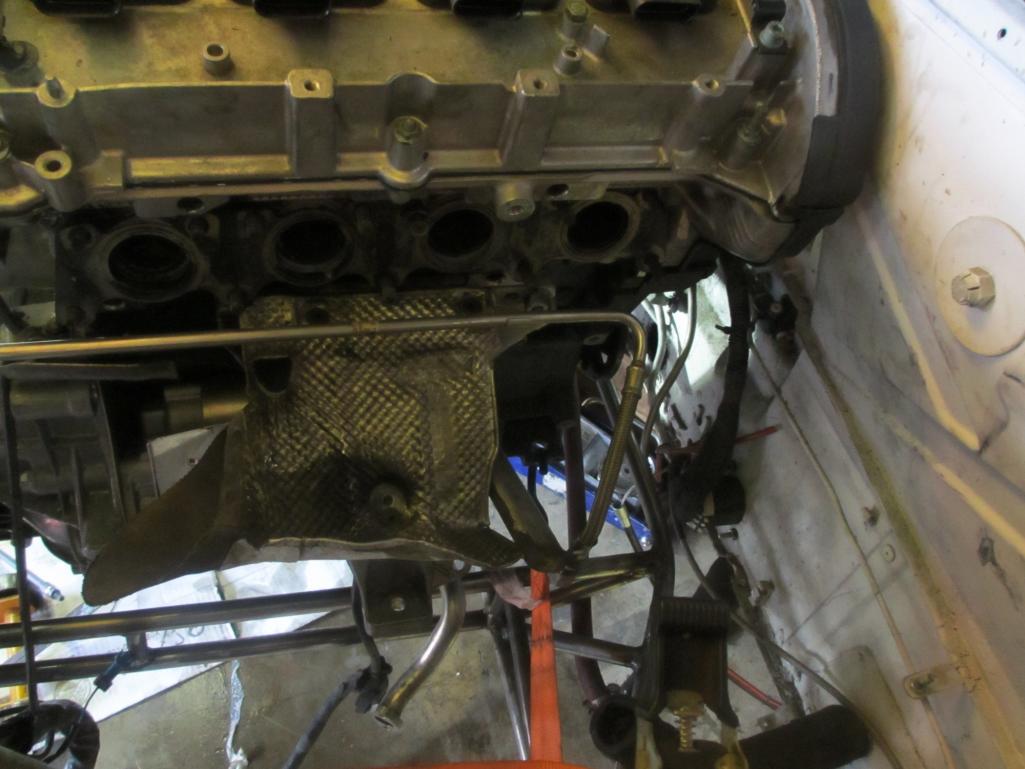

One more just for fun...
Engine in the bay. I will have to make room in the rear trunk for the valve cover, exhaust and intake. I picked up a new aluminum intake manifold since the stocker won't work (angle problem) this one allows the TB to be installed in front of in back. I am mounting it in the back and it will also crowd the trunk a little...

kg6dxn   One more just for fun... Engine in the bay. I wil...   Oct 6 2012, 09:48 PM

kg6dxn   Here she is in all her glory. Engine mounted to th...   Oct 13 2012, 07:01 PM
kg6dxn   The cool thing about the OBX (don't laugh) int...   Oct 13 2012, 07:10 PM
