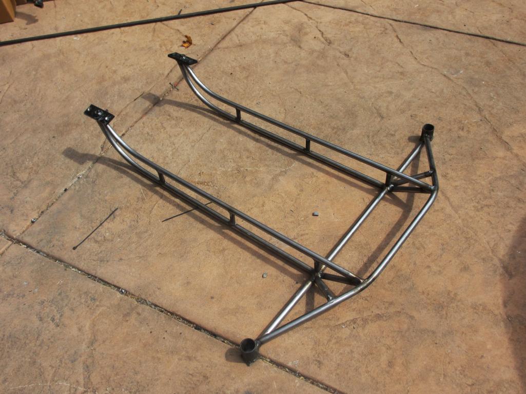

Mike, the crade looks amazing! Do you have a mandrel pipe bender? I can't believe the engine fits as well as it does. If you want to make the intake work without cutting the truck, you're welcome to play with my TIG welder anytime. (IMG:style_emoticons/default/thumb3d.gif)
Mike Bellis
post Oct 7 2012, 10:01 AM
Resident Electrician
Posts: 8,348
Joined: 22-June 09
From: Midlothian TX
Member No.: 10,496
QUOTE(McMark @ Oct 7 2012, 08:48 AM) *
As an Electrician, I have access to various pipe benders. I used my hand/shoe bender for these since it is such small diameter tubing. It would have been easier and lighter if I used thinner wall tubing.
You saw how my old cradle was sagging (rotary) due to the lack of a rear support. This time I wanted no sagging or flex. I think I achieved it considering the weight of the engine is sitting on a copper shim, sitting on the single 3/4" horizontal runner.
Time to get back to work!
I added some more triangulation since these first pics. I will add more pics when I get it finished...
